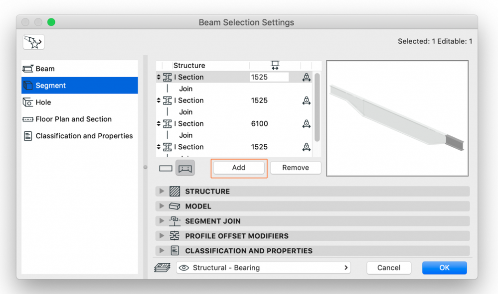

How to add a new Segment?
In the Settings Dialog Box
  • Open Beam Settings and go to the Segment page.
  • Click the Multi-Segment beam icon.
  • Click Add to add as many segments as needed.

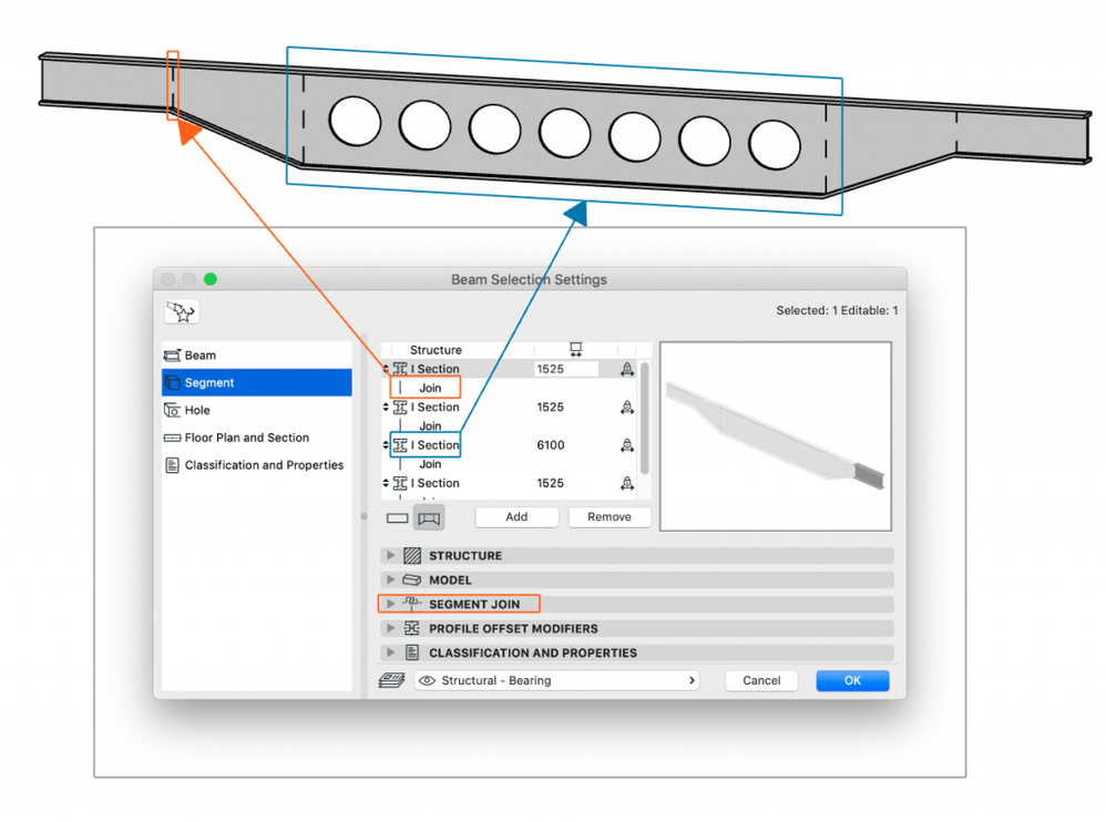

What is a Segment Join?
The Segment Join defines how two adjacent Beam Segments should connect.
There are 3 options:
  • Vertical cut
  • Horizontal cut
  • Custom cut
To define the Segment Join, select the Join component in the Segment list of the Beam Settings Dialog Box (at the top of Beam Segment Settings). Then use the Segment Join panel (below) to define its angle as horizontal, vertical or custom.

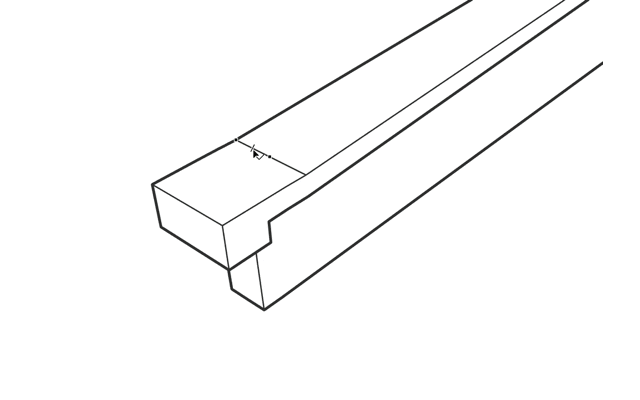

You can also define it graphically:
  • Select the Beam in the 3D window
  • Click the Join hotspot
  • On the pet palette, use Rotate Join Angle to adjust the Join angle

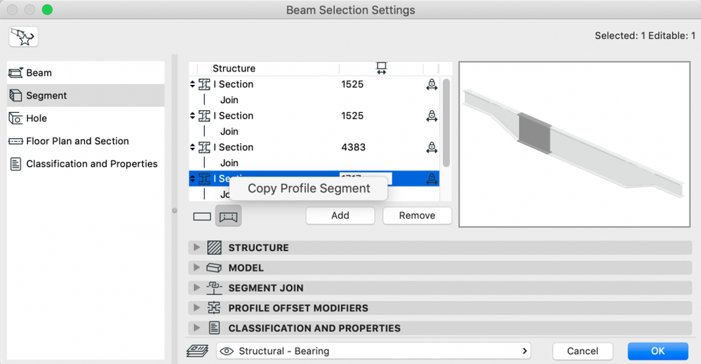

How to copy a Segment?
  • Right-click on one of the Segments in the list of Segments in the Beam Settings Dialog box
  • Select Copy Rectangular/Circular/Profile Segment
  • Right-click on another Segment in the list
  • Select Paste Profile/Rectangular/Circular/Profil Segment
If you switch to the 3D window and turn on Edit mode, you can pick up and inject the parameters of a Segment into another one using the Eye-Dropper and the Syringe. This option works only within one Beam, you cannot inject the parameters of a Segment into a Segment of another Beam.

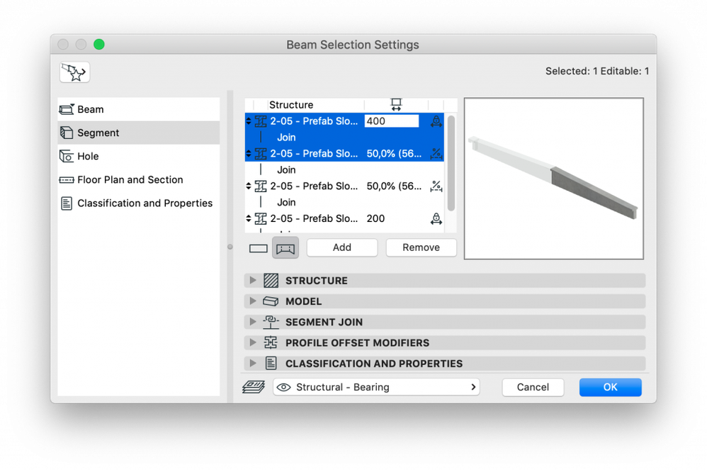

How to fix/change the Segment length?
For each selected segment: define its length by clicking on the corresponding icon in the Structure panel of the Beam Settings dialog. You can define the length of the segment in either of the following ways:
  • fixed: Define the length by entering its value numerically. It will remain unchanged even if the beam stretches.
  • flexible: Define its length as a percentage of the total length of all flexible-length segments. Segment length will stretch accordingly if the beam stretches.
This information is displayed in the list of segments and on the Structure panel of the Settings dialog.
Of course, you can edit the Segment length in the 3D window graphically as well. Select the Beam, click on the Join hotspot (black dot on the blue line) and use Move Segment Join command on the Pet Palette.
