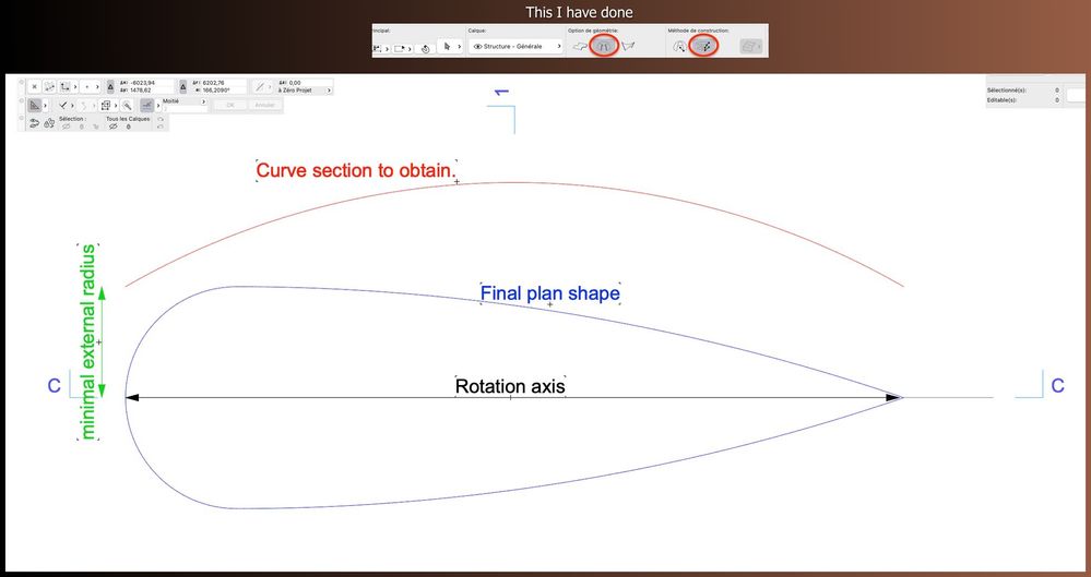

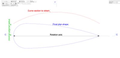

Hi, it's not so difficult with the Shell Tool.
First in plan view draw your plan shape and the section curve you want with lines, circles or polylines. Refer to example below for Element to consider that will define your Shell.
 Set the Shell Tool geometrical Option to by Revolution and the detailed input method.
Then magic wand the curve section to define it and clic the 2 points that define the rotation axis.
The result in 3D, sections C, 1 and plan for my example is as below.

 You now have to define the Shell contour.
 And the final result:
