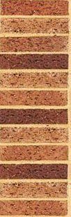

Not sure if this is of any use.
It isn't quite the same as the aged brickwork, but it is a variegated darker brick in stack-bond.
Something I made for the same purpose.
I left the mortar joint at the end of the brick, just so you can't have an impossible long brick.
This images is designed to be 1029mm x 240mm.

Thanks @Barry Kelly, that might come in handy.

Hi all, I was able to find another old brick texture from SU club website that had a soldiers course pattern at the bottom of it. I edited it in a free Mac photo editing app and used it instead. Turned out ok.
Thank for the tips above.
Extra Info: I just cropped a picture of the “Aged Natural” brick surface in AC down to a single brick with mortar on one side. Worked ok but you need to have a variation of bricks to make it look more realistic. If the aged natural brick in AC came with a stack bond image it would work correctly.
