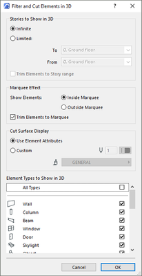

In the '3D Filter' options you can limit by a range of storeys and limit to the bounds of those storeys.
You can view inside or outside of the marquee.
You can trim to the marquee or show the full extent of the elements in the marquee.
You can also show/hide particular element types.
