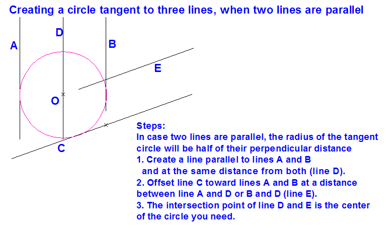

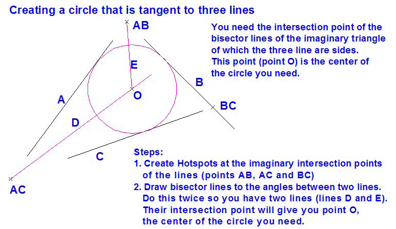

I think the circle tangent to three line solution was not yet posted.
Here it is.
Laszlo
Here is another one that is a specialized case of the previous one.

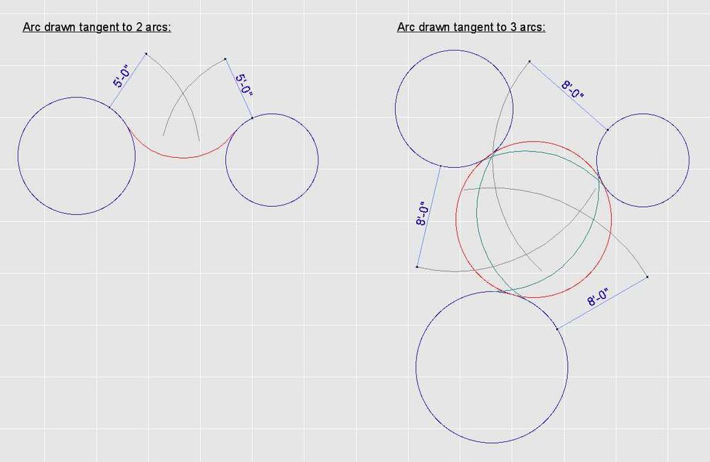

Here are some solutions for two and three circle tangents. (It would be nice to have the geometry methods built-in - something to add to the wish list I guess.)
The methods should be mostly obvious from the figures.
The gray arcs are swung using center and radius with numeric entry using the r > value > + method.
The intersections of the gray arcs are the centers of the tangents to two circles.
The three circle tangent is drawn using the three point geometry method to the centers of the arcs between the two circle tangents (light teal arcs).
OOPS... On closer inspection the three circle tangent is not quite accurate. This will require a little closer study.
