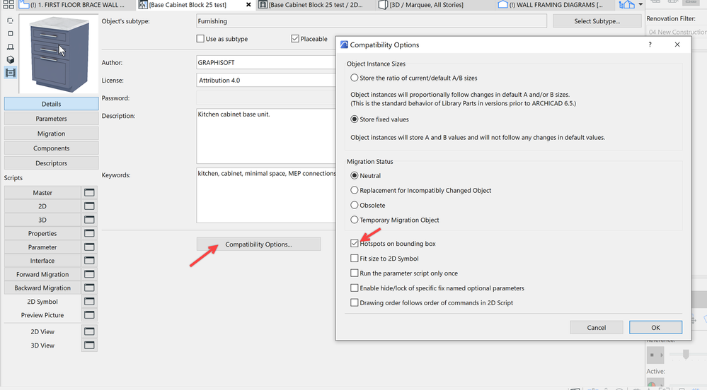

Its a Compatibility option/problem/setting.
Open the Object and you can fix by changing the settings

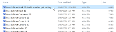

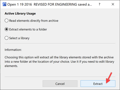

There is a way to get any modified object back into your Master/Default  .lfc ( if you want to call it that).
you can use the Extract/Create Container functions.  And you may want to do it using a .pla.
When you open a .pla there is a pop-up the gives you the option of extracting the library parts to a folder.
When you do that, all of the library parts are now available as individual .gsm files.  From there you can rename the modified part and delete the default part.  You will be able to tell that the part has been modified even if you us the default part name by the Date Modified displayed in the folder
( Windows folders anyway, I don't know anything about macOS folders, probably similar)  Then when you load that new/modified .lfc the object will be as per your modifications.
