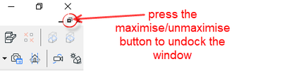

Yes, just the same as with any version of Windows.
Press the maximise/unmaximise button (restore down) to undock the window from the TAB bar.
Then resize and position the window as necessary.
Be aware that only one window will be active.
Make changes in one window, the others do not update until you click in one of them to activate that window.
