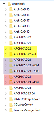

@emirefek wrote:
It's not possible to install Archicad 2 times in Windows PC. Installer doing registery check before start and if installer founds already installed Archicad it asks about do you want repair or uninstall, not asking about if you want second installation.
Installing multiple versions on the same PC is possible, just rename the program folder before you install the next version.
I do this often, but must admit I have not tried installing the EDU version with commercial ones.
I am sure that can be done though - I recall there are other posts here about running EDU and commercial at the same time.
Also as Eduardo has said, opening an EDU file with a commercial licence will force the commercial version to run in EDU mode and the file will remain EDU.
You just won't be able to start a new EDU file without the EDU version - but is that a problem?
I am not sure if you create a new commercial file, then open it at university with an EDU license, does it switch the file to EDU?
If so there is no problem at all.
But if EDU can not open a commercial file at all - that may be an issue if you need to create new files.
Unless you can create them with an EDU license on another machine first.
