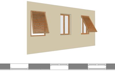

How to create this type of Bahama Shutter in Archicad 28: Mac Silicon Education Version?

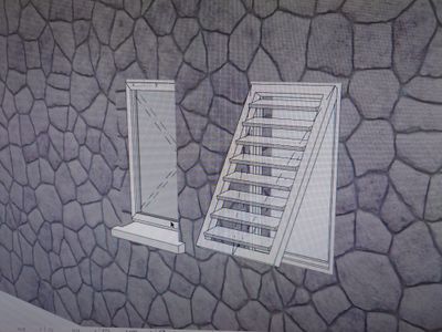

What we usually do is make two windows : one for the glass and on for the shutters  
Then combine them

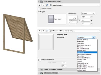

Create a normal window and a separate shutter made with the main sash opening type as Top hung and sash type as Vent sash then place one top of the other.
