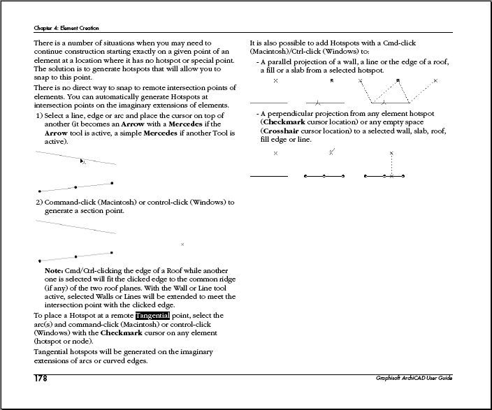

what does Cmd-Clicking in the space between the two circles when they are selected do?
i know that with lines, archicad puts down a whole load of intersection hotspots. i've not got archicad open at the moment, so i can't tell you for sure, but it could be worth a try - it may put down hotspots from which you can define the tangental line . . . ?
fingers crossed.
[UPDATE HAVING JUST CHECKED THE MANUAL!
See attached screenshot. seems that archicad will generate remote tangental points based on selected arcs. i wonder if it will work with full circles, or whether you will have to cut a piece out of them to get it to work?]
~/archiben

~/archiben wrote:
Seems that archicad will generate remote tangental points based on selected arcs. i wonder if it will work with full circles, or whether you will have to cut a piece out of them to get it to work?
I tried it on circles and ellipses and it worked on both. That's a pretty strange way to get tangents!
__archiben
jay
you have to be careful - i am now back in the office and have tried the Cmd-click method and the tangent hotspot points that archicad creates are tangental to the point at which you click.
this may not be what you are looking for when you wanted to produce a tangent line between two circles/arcs.
sorry for the misinformation.
~/archiben
