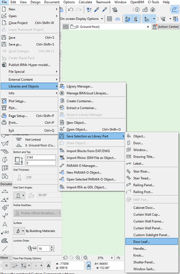

I have created a door leaf from a slab like I have done in the past versions but there is no option to save selection as....... anything. No options.
I can save a gsm but then cannot load as a custom door leaf.
Libraries and objects offers no options to save as door or anything else either.

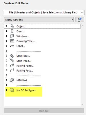

So what you are saying is you don't see this?
2 things I can think of.
The Work Environment you are using does not have these items in the menus ...
Or the library that you have loaded does not contain the correct macros to allow for the custom objects ...
These images are from version 24 & 25 - not 18 if that is indeed what you are using.

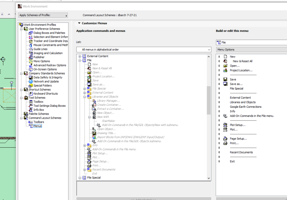

David Bearss
I was using a customized layout scheme and had not included that menu item. I had to switch my layout scheme back to default to get it to show up and work. Question now is why can I not add to my custom layout scheme? All menu items are greyed out.
David Bearss
Archicad 28/Windows 11
Alienware 17 R5
i7 2.4 GHz / 16 GB ram
You are looking at 'All menus in alphabetical order'.
This is only good if you want to add an entire menu or sub-menu.
You want 'All commands in alphabetical order'.
