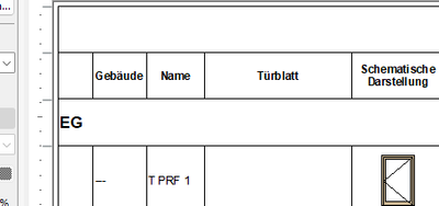

Does anyone know why is it not possible to change the name of the Story in Archicad list?
I thin it should be possible, but when I double click I don´t have the option to change it.
It is a teamwork file in Archicad 25, but I have everything reserved.
Operating system used: Windows 11 Pro 23H2

Normally it is the name of the story in the storysettings (ctrl-7 / command-7) You can edit them there or under stories in the 'project map'
It is not possible to do it in the shedule.
Apple M1 Max 32 GB Ventura
AC27

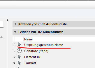

thank you for your reply.
I think it is possible to change somehow, because in one (same Archicad files) I have different names of stores in the shedules and am not sure how the Authro achieved that.
here we see two lists connected to the same stories in the same Archicad file with different names:
Both use the same parameters (story name) in the Schedule:
