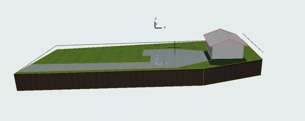

Hi everyone,
I'm currently a student and still learning Archicad, so apologies if this is a basic question.
With CiTools Boundary, is it normal for the 3D model to display the horizontal lines shown in the attached screenshot?

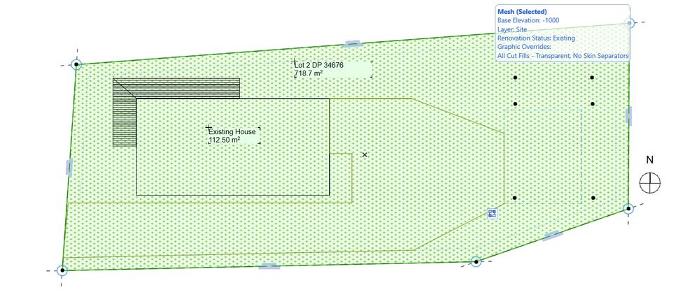

Also, could someone please explain why my driveway is visible in the 3D model, but in the 2D plan it appears to be covered by the mesh, as shown in the attached image?
I'd really appreciate any guidance on what might be causing this or where I should start troubleshooting.
Thanks in advance for your help!

Elements on your 2D plan do not take into consideration their actual vertical position in terms of their general visibility. This means that the Fill for your Mesh can cover the Lines of your driveway. You can edit the Display Order to correct this. Each element type has it's own default display order, but elements can be shifted through this order at any time.
https://help.graphisoft.com/AC/29/INT/_AC29_Help/030_Interaction/030_Interaction-102.htm
