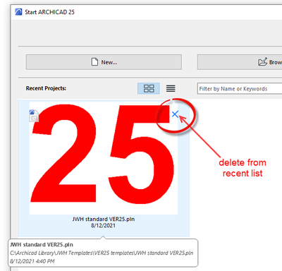

This is a reply to a very old post.
While it still may be valid, this will delete ALL from the recent list.
In the new versions with the start-up dialogue box, you can remove individual files from the recent list.
Whether it is displayed as icons or a list - just click the little blue delete cross.
