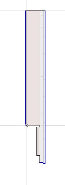

Note: when I delete the basement CP wall below, the intersection clears up. attached is a section view of the walls.
showing the walls cut back

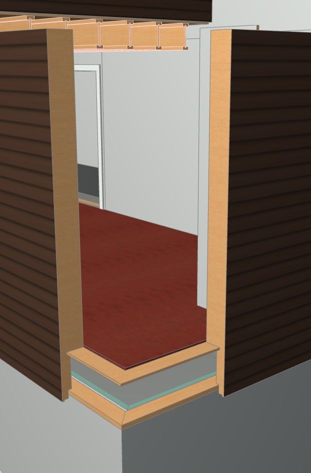

intersected
messy intersection carries through from bottom to top.
Any ideas?
The wall, because of the height, was showing on the basement plan and thus trying to heal itself into the basement walls as well, which was causing the problem. SORRY!
