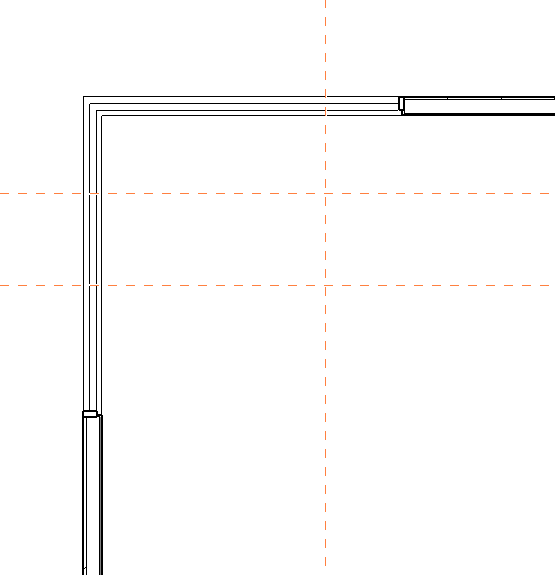

section
and the wall and footing as a Complex profile.
this is one of several wall types from a project I am working on and because it has several different split levels I found it easier to set the wall and footing together...it is so much easier and quicker than placing the footings seperately

Anyhow...there wasn't much involved in setting up a corner window.

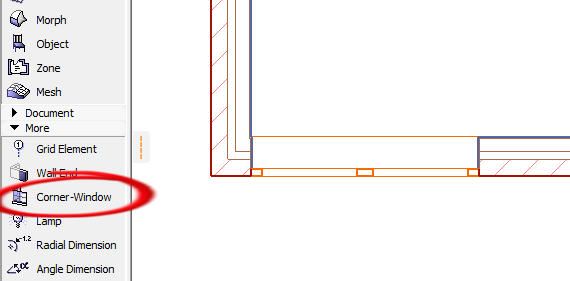

Are you using the Corner Window tool from the Tool Box, or the Corner Window function from the Settings Dialogue Box ?
...for what it's worth I'm using it from the Toolbox.
I'll try the other way and see if that gives me any problems.

I was trying with the corner window tool in the tool box.
With a CP wall it is just places at the end of one wall.
With a standard wall it duplicates around the corner as it should.

I just tried the default 'Custom Wall' Complex Profile from the Wall Dialogue box to make sure I hadn't 'fluked' anything in my own set up.
It also worked ok.
Give it a try and see what happens.
Still no luck for me.
New and reset - custom complex profile wall or any of the other CP wall in the template.
Tried the built-in corner window object and also others from the GS AUS library - all with no luck.
