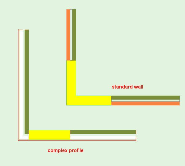

OK Graphisoft why is it that I cannot use the Corner Window option with Complex Walls.
Complex profiles are one of the most useful features in the current ArchCAD and corner windows are an architects dream but the two don't /can't come together.
When are we going to be able to place corner windows onto complex walls?

I was trying with the corner window tool in the tool box.
With a CP wall it is just places at the end of one wall.
With a standard wall it duplicates around the corner as it should.

I just tried the default 'Custom Wall' Complex Profile from the Wall Dialogue box to make sure I hadn't 'fluked' anything in my own set up.
It also worked ok.
Give it a try and see what happens.
Still no luck for me.
New and reset - custom complex profile wall or any of the other CP wall in the template.
Tried the built-in corner window object and also others from the GS AUS library - all with no luck.
