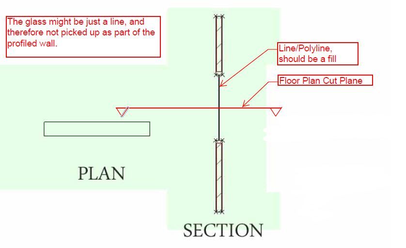

I'm not sure, but the problem might be the profile itself.
What if the glass is just a line?
