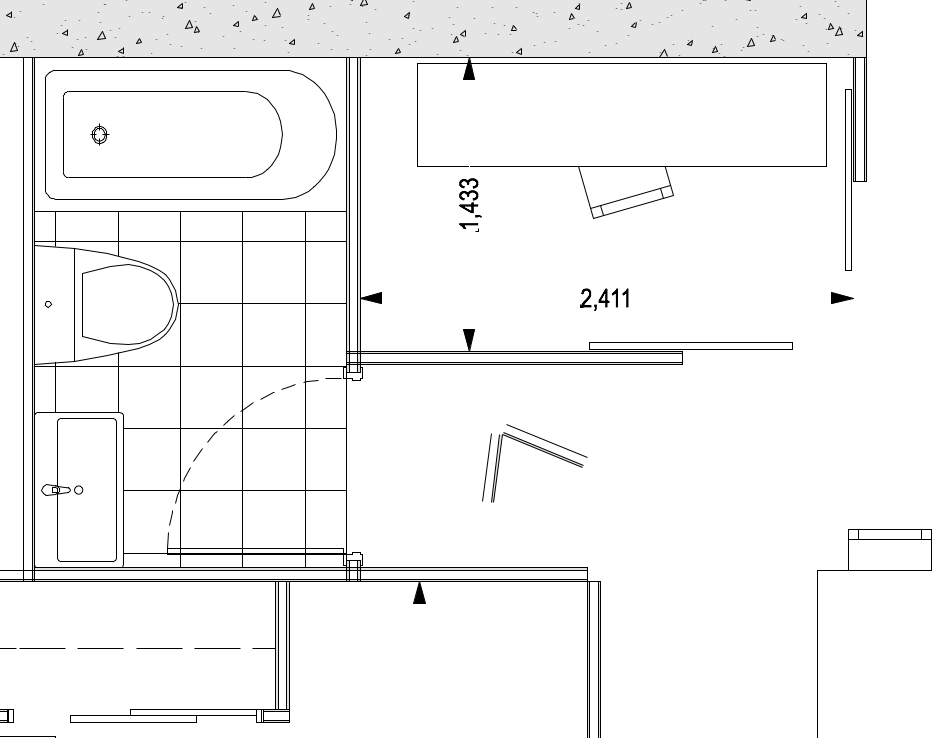

We are experiencing a similar problem to this with complex profile walls. Wondering if anyone can shed light on this.
Our file was working fine until yesterday (working in Teamwork with AC16) when suddenly all partitions stopped intersecting and cleaning up properly. Is there an option somewhere that I am missing? If I draw 2 new and identical partitions they won't intersect properly either (see attached screen grab)
- complex profile all set / working fine in similar files. All priorities are coordinated.
- all settings of wall partition are identical
- all view map functions are unchanged.
- DOO is set to clean wall intersections.
- Renovation status does not have any "Do not intersect" settings turned on.
Has something gone corrupt? And is there a cache that might need purging?

Go to: View > On-Screen View Options > Clean Wall & Beam Intersections
Pretty sure you accidentally turned that off.
