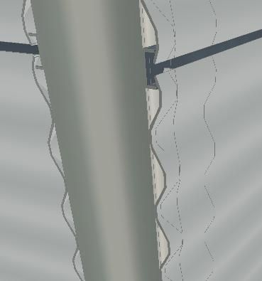

I built a complex profile wall, and it is intersecting with itself in 2d, but not at all in 3d. The reference lines intersect. They were on one side. I moved them to the center of the wall because I thought that might help, but it didn't.
I've built complex profile walls before without this problem. The major difference is the corrugated siding which uses curves and the cavities formed behind it.
Any ideas how to make this work?

I can't quite work out what is happening in the 3d view. Can you post a shot preferably showing the top or bottom edges?
I suspect you have another wall with the same layer intersection number hitting that corner either on a hidden layer, or intersecting it above or below.
Also check for any wall reference lines that are offset from their actual geometry that may not be obviously connected.
Just to make sure I moved the walls 1000' off.
This shows the reference lines centered and intersecting.
the 3d intersections fail when the profile is applied, even though the reference lines are intersecting and the 2d plan view of the wall is as expected.
here's a close up of the top
This looks like an issue with priority levels of the different fills in the custom profile.
1) is enable skin priorities checked in the floor plan and section dialog box of the placed walls?
2) make sure the fills for the corrugated metal have a priority number less than the rest of the wall. The priority numbers will tell ArchiCAD what should/shouldn't merge.
That should solve it. I don't think it matters what is/isn't listed as a core component (though that will be important later for dimensioning).

thanks, If only I could get it to work
-enable skin priorities is checked on all three walls
-I set the channels and corrugated metal to 2 and checked finish component, the sheathing to 4, and the stud to 8 and core component. Horizontal stretch is located at the faces of the stud wall, the opening line is located 1/16 out from the corrugation.
Do you know if it could be the corrugation? I was thinking I've never used curves in a complex profile, but I just remembered I used one to make a table edge once.
I remember seeing this in the AC10 beta. I can't remember exactly but I think it had to do with the origin (thus reference line) somehow. If you can't sort it out you can clean up the 3D with SEOs.
