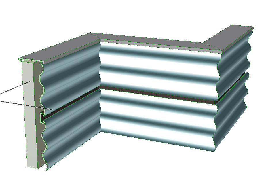

I built a complex profile wall, and it is intersecting with itself in 2d, but not at all in 3d. The reference lines intersect. They were on one side. I moved them to the center of the wall because I thought that might help, but it didn't.
I've built complex profile walls before without this problem. The major difference is the corrugated siding which uses curves and the cavities formed behind it.
Any ideas how to make this work?

I remember seeing this in the AC10 beta. I can't remember exactly but I think it had to do with the origin (thus reference line) somehow. If you can't sort it out you can clean up the 3D with SEOs.
The origin? You mean a project scale/accuracy limit problem? The curves require more precision than is available with current settings? I've seen something like that but it had to do with rendering shadows and was in a different program.

The problem went away when I moved the corrugated fill 1/16th off the sheathing?

Try to make the corrugated layer with the highest priority!

Yes but... In the profile move the metal channels and corrugation so that it is touching the wall element, and this will cause the error?
Touching now
