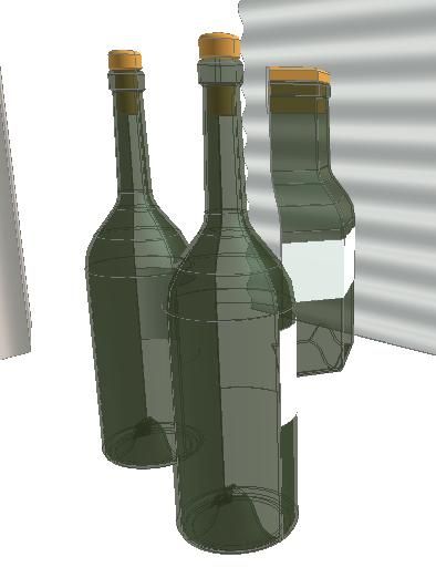

I also included some wine bottle profiles I made to tests things and although I didn't encounter a similar error, I noticed some problems. If you examine the image you'll notice that on one bottle the cork is broken and you see through the back of the label. The precedences had no effect on this. What did help was to offset the cork and label so they were not touching the bottle. And besides that the glass looks funny. I think it's not controlling the face normals properly?
