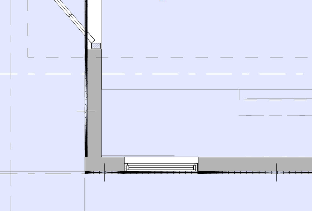

I would like to revisit this question. I always used small slabs with SEO to do this, but recently thought that the "opening" tool might work better.  It seems to work OK, but I'm having 2 problems:  first, in plan they show up in a way that I do not like and it's impossible to turn them off because they are a part of the wall;  second, they don't seem to want to wrap around wall corners?  I think that maybe just using SEO to create reveals is better.  How do other people do this?Screen Shot 2021-09-23 at 10.02.08 AM.pngScreen Shot 2021-09-23 at 10.01.55 AM.png
