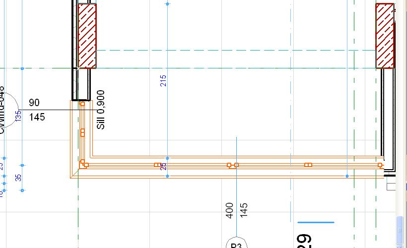

Hi all,
I placede a corner window like in the picture. I streched the right one to the right when i want to strech the left one , the corner window changes normal window. In the parameter of corner windows there is an option " corner window fuction". when i strech the left one it turns to " off " then i change it to " on" but it doesn't change. how can i correct it?
5 Replies 5
when i sterch it 90 to 135 this is the result
that's because you stretched corner window to the end of the wall. I had the same problem in AC9 and as you can see nothing has changed in 10. It's a pity

Yes archimax
it was caused by that problem. i deleted the wall under the column and i streched the upper wall. After this operation i can place the corner window. Nearly i was becoming cancer
