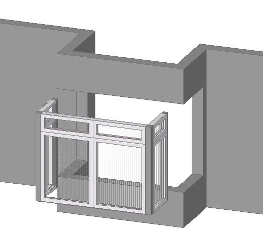

How can I make this corner-window with or without any fakes?

The asymmetry is a problem. I haven't used the corner window tool in a while so I just checked and it seems to insist on placing the same window on both sides of the corner. If you have a simple window type that you can make to overlap at the corner this might work.
Otherwise you can make a couple of custom windows. Make two different corner windows, make the walls only as big as the windows, model only one side at a time, and save each result from the 3D window as a custom part. To get the plan looking right you will also have to clean up the 2D symbols by either copy/paste from a 3D section or manual editing in the library parts.
I've just found another messy way to do it. Overlap two pairs of walls, each having a different set of corner windows. Then move opposite halves of each pair to a hidden layer. Make sure the reference lines of each pair don't line up to each other. This is very clumsy and may not work for a variety of reasons I don't have time to test.

I have just found one other clumsy possibility. If the two windows are the same dimensions and the type used has enough internal variations to do what you want then it might work. It seems that you can change the internal parameter settings of the two sides of the corner window independently.

so I need 3 windows connected over 2 corners... how?
Here is the old tried and true work around for tricky doors and windows.
Make walls the exact size of the desired opening, fill them with the windows, and insert the assembly into openings or voids in the building. Make the inset walls the correct thickness to form the corner mullion. Watch out for the wall reference lines.

Door and Window Builder (CadImage) allows you to join any windows at a corner, not even requiring the corner window tool.
On the attached image you can see the options:
1 - normal frame
2 - mitre with corner frame
3 - mitre with no frame (butt glazing)
You can do this for any angle wall junction.
