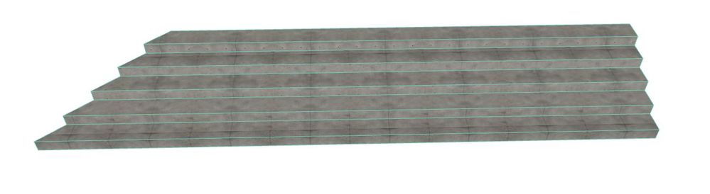

Hello everyone.
This is a example 3D model I want to create as a Stair object.
I tried to use "Create Stair Using Selection" option but as the total elevation is only 75 CM (5 15x30 threads) it doesn't allow me create it. I thought this was because of every custom stair I created was 300 total elevation as default. Is there a way to modify this?
I'm not sure if I explained it clearly, I'll provide additional information if you need.
1 REPLY 1
You don't need to use the stair tool for modeling stairs. In fact it is never my first choice. Just use slab, mesh, morph, roof, complex profiles, etc...
