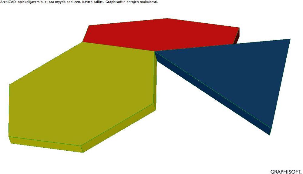

Creating an object in a 3-dimensional coordinate system
What's the best way to create an object (or a slab, or whatever is the best option...) between the yellow and the blue shapes.
The red hexagon is horizontal, and the others are rotated in different angles using the z line.
So basically the question is, that how can i create an object (in this case, a triangle) using three different points in a 3-dimensional coordinate system?
Hopefully the attached image tells enough about the situation.
-M

Make the shape of your object using a slab, save it as a GDL object, then open the GDL object to edit it. When the GDL object is opened for editing, go to the 3D Script section, and type in the following Code (with the assumption that the angle is 3.5 just for an example):
ROTX 3.5
Put this at the very top of the 3D Script section.
You may have to try different angles to get it to work correctly, but just replace the 3.5 (above) with whatever angle ends of working.
HTH

I actually have made a slab, then turned it into a GDL object. But the new object never fits perfectly into the hole. Is there a way to strech the objects corners to different points in 3D coordinate system? Without it resizing the hole object, that is.
That would be the easiest way for me, because I have to fill guite many of those "holes". If I could use just one or two objects (shaped a triangle and a square) and stretch the corners in to right places.

i would use a mesh 1,
then copy the mesh 2 and lower it to the thickness of the other objects, then SEO one mesh from the other then hide mesh 2.
Use the "Roof Tool" direct in 3D Window.
Thanks for all the help guys. Found the help I was looking for behind Adrians link.
Turns out, that in 3D view you can draw a roof using those three known points. I now filled that triangle shaped hole, next up is a square hole. Hopefully it works the same way.
I haven't used ArchiCAD that long, and the mesh tool is new to me. Or actually I have never heard about it before. That sounds something worth studying for. Also I'm using the finnish version, so I'm not sure what it's called here
marcusk:
Only if the 4 points are on the same plane, otherwise you will need to use 2 triangles.
