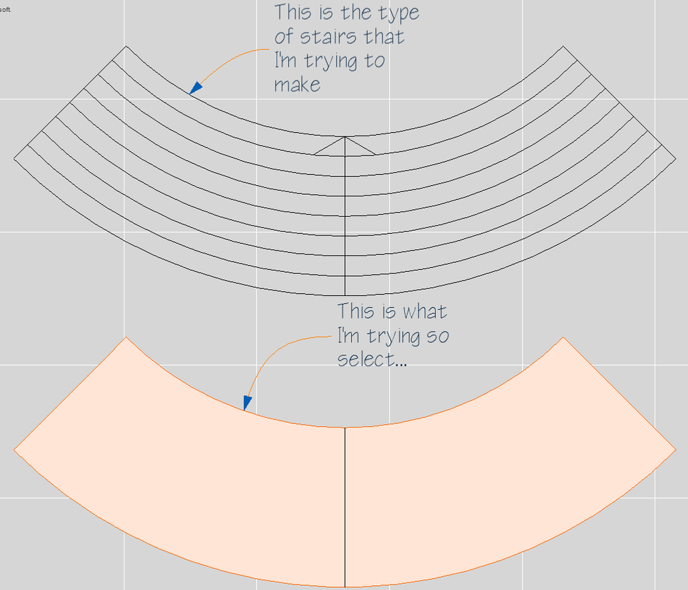

Hello,
I was trying to make stairs using the tool "Create Stair Using Selection" but every time I try a message shows: Line of travel endpoints must not connect to adjacent edges or nodes of the fill polygon! >>>
>See the picture<

"Line of travel endpoints must not connect to adjacent edges or nodes of the fill polygon!" .....This statement is a bit complicated!
For your example use slab, arced walls, conus object and SEO.
Or add-ons ArchiStair, Stair Builder.

Another option is to use the stair tool.
It has an option for a "circular" stair (with space in the middle.) Select from the choice in the 'stair type selection' box and then you can set the portion of the circle the stair will fill such as 180° or 123° that you see in the plan.

Another option:
You could also try to model this stair using complex profiles.

THANK YOU SOOOO MUCH!!! that helped! 🙂 it's really simple with SEO. thank you
