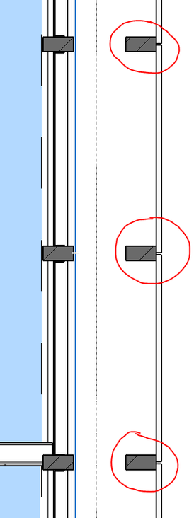

on one of our recent models, we had a curtain wall with double glazing panels set up.
When we initially had a single glazed panel, the linework showed correctly in plan view (image 1), wherein the panels join at center of the mullion.
However, when changed to a doubled glazed panel, the line abruptly cuts off at the corner of the mullion .
Tried various settings and tools to fix it but can't seem to find the solution. Would anyone have an idea about this?

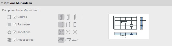

Hello as,
You should check your model view definition parameters.
