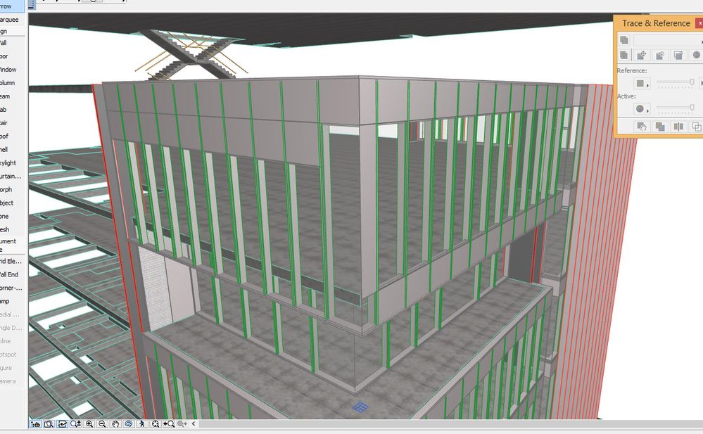

Hi
I am using the curtain wall tool and as you can see from the attached screenshot I have one which turns a 90 degree corner. My problem is that when I try to edit the overall settings for this wall, the settings I use only apply to 1 part of the wall and not the whole 2 sides. For example I want to have a main glazed panel with a distinct aluminum panel above and below it as you can see from the attached image. So this works for the right side of the wall but the left side of the wall places the 2 distinct panels in a different location. So I am not sure why the general settings for the wall does not apply for both sides? The 2 sides are connected and are 1 wall so I thought the same settings should apply?

Hi.
This may happen if you edited the curtain wall's scheme (moved origin, changed some panels, etc) for each side. Go into edit mode, select both schemes and then try to change the general settings.
