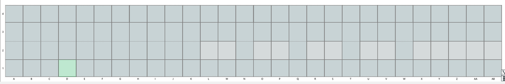

Curtain Wall usage is cruel by design, sorry.
If i have large pattern, i use mouse in degenerative way.
Why not to add dots for selecting edges?
Or why not use KB arrows +alt+ctrl maybe to select next detail in raw,column? With shift to select several. Why?
It is **beep** nowaday to use curtain wall tool
4 Replies 4

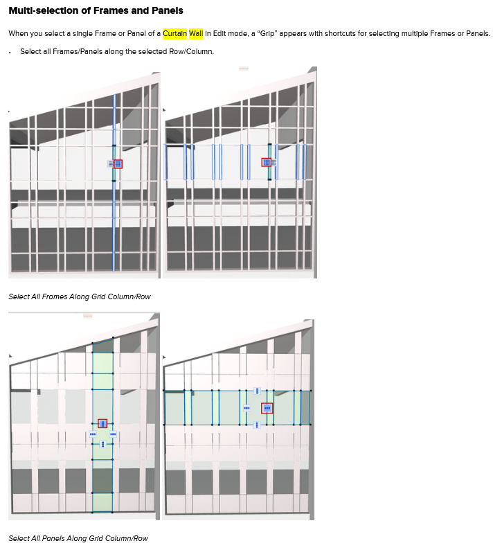

Do the selection grips help with what you want?
Nikitron
Obviuos not!
See in screenshot there is dialog window, not 3D.

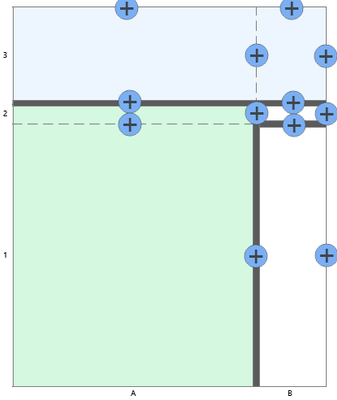

But in other software there are dots with + or - symbol to certainly select part. WITH SNAP
Your first image shows those grip controls?
Nikitron
it is not the same. you have to point mouse to line, that is thin.
Or let zoom editor
