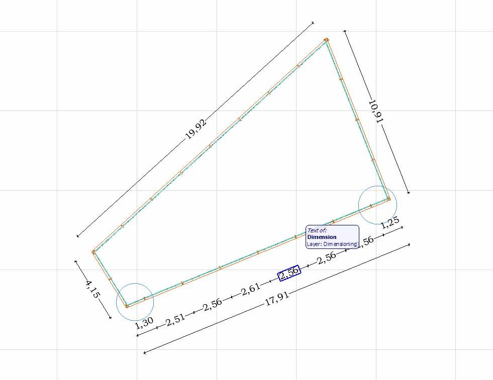

I wanted to ask sth if anybody knows, I m trying to place a curtain wall object in v.13 and instead of having all the parts equal, it generates a wall with the first and the last part cut in the middle. See the image attached because I cannot describe it further.
I wanted to know how it can be done like the above large side.

On the Scheme settings there is a choice of Pattern Positions at the bottom of the box where you can choose where the pattern starts, center, end etc.

Yes!!!! Thank you so much!!!
