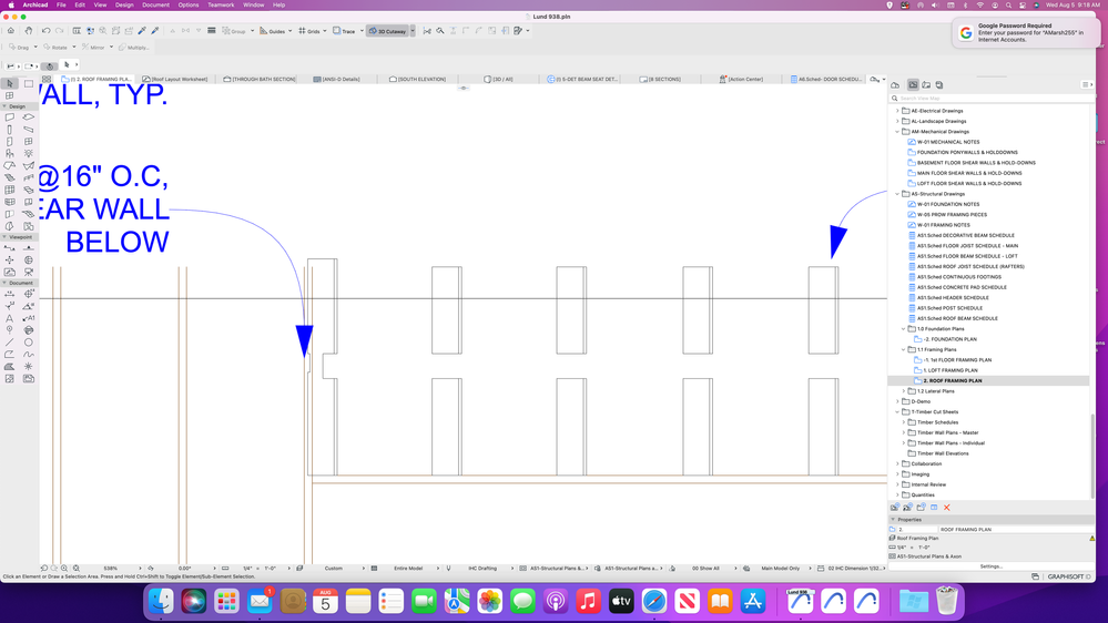

I'm drawing a house plan, putting in outlookers on the roof. Only problem is, they are trimming (splitting) to the wall below. How do I stop/fix this?
3 weeks ago - last edited 3 weeks ago
I assume they are modeled as beams?
Have them use a Building Material with a lower Intersection Priority than that of your wall, or put them on a layer with a different Intersection Group.
