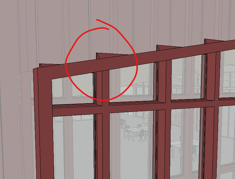

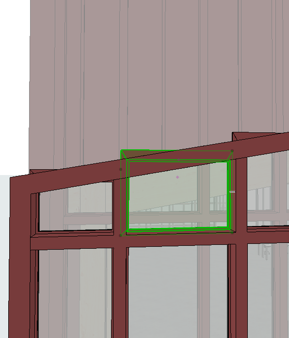

I am new to modelling using the curtain wall tool. I have adjusted the scheme grid in the edit window to be triangular, however the windows that I place as panels do not crop to the triangular grid.
What is the reason for this, how do I adjust or remodel in order for the window frame to follow the triangular scheme grid?

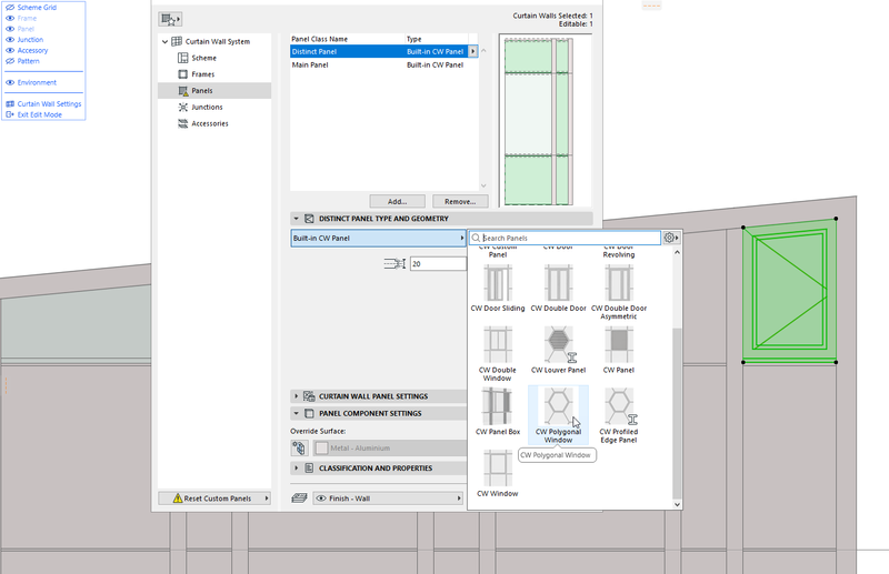

Try to use the "CW Polygonal Window" Panel.
