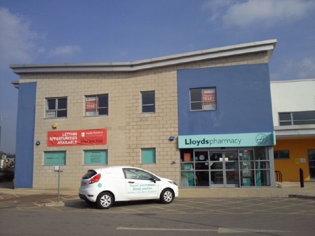

I've been asked to produce a model of the building in the photograph. Most of the building is complete but I'm struggling to model the glazing shown in the photo (below the pharmacy sign). I've tried using standard windows, but as the unit comprises curtain framing sections and design I can't achieve the same appearance with multiple 'ganged' windows. I've therefore been trying the curtain walling tool, however that's thrown up two problems:
  • I can't achieve a corner piece of the type shown in the photos (it's always angled 45 degrees) - I have tried drawing the two sides independently and joining them but have yet to successfully achieve a single unit this way
  • Hiding the frame section where the door will be results in an awkward gap either side of the door

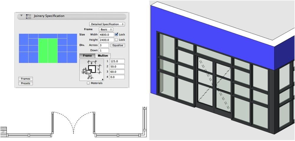

This would be straightforward using the Modular Joinery object. It can quite readily adapt to any arrangement of doors/windows/panels - I've used it to create something like the image you posted (see attached image).

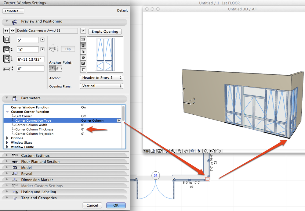

Another option is to use the corner window feature which has an option for a column in the corner whose size you can set. I combined it with a storefront door in the screenshot.

If you need a specific corner detail, the Modular Joinery gives you 3 types to choose from (see attached).
