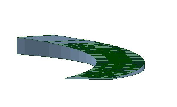

Hi people its me again can anyone show me how to do a Curve Stramp. I can do a curve ramp using mesh tool and i have tried to use stair maker but i can not create a Stramp, somebody has suggested me to use roof tool over a curve stair, i have tried unsucessfully, can anyone show me the CORRECT way to create a Curve Stramp. thanks alot

i'm assuming you mean that each tread is ramped, followed by a riser
draw the first tread wirth arcs and lines
magic wand a mesh into this
elevate the 'top' end of your tread with the pet pallette
multiply, rotate and elevate
if you need a nice smooth underside to your stramp, create a similar thang underneath (riser=elevate) and SEO that from the stramp
hope that makes sense, if not happy to elucidate

Hi Bill Shorten, take a look at the photo, did i do the correct way that you show me? cuz when i elevate the top of the Stramp, it also increased the thickness of that end, which i does not want or did i do it wrong?

Use the Mesh to Roof tool.
Hi Mark Flamer
Can u be more specific about the Mesh to Roof tools? cuz i did not quite get it. Thanks
lovetrain
Draw 2 circles or arcs representing the inner and outer radiuses of your ramp. Divide the circles radialy from the center of the 2 arcs like pieces of pie. Do this in increments of degrees based on the total degrees of the arcs ( If your ramp is a 180 degree arc use 20 degrees or something like that). Magic wand a mesh into the space between the 2 arcs and your radial lines that represents the bottom of your ramp. Set the elevation of the 2 nodes that are the starting edge of your ramp to 0 and the 2 nodes on the uphill side of your ramp to an elevation based on the total rise of your ramp divided by the number of segments you split the arcs into. Select the mesh and use the Mesh to Roof tool to convert the mesh into a grouped cluster of roofs with the appropiate fill and thickness. Select the roof and use the Multiply-Rotate command. In the Multiply settings set the method to rotate & spread. Set the degrees to the same number as the lines dividing the arcs and the elevate setting to the same elevation as you set the uphill side of the original mesh to. Multiply around the center of the arcs. Select all the roofs and group. Switch to the 3D window and there it is! Hope this makes sense.
