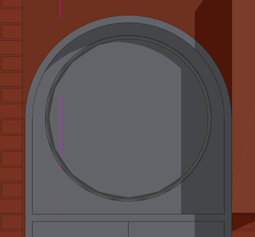

Hi everyone, sorry if this has been answered elsewhere but I'm trying to fix an export of a curved fill. I've got a ring around a sign which I've done in 2D fill. Before I export it to PDF the fill is fine but then in the PDF the fill segments out making the edges of the fill not smooth. Anyone know how I can fix this?
Top: In the PLN
Below: in the PDF after exporting
In the PLN Segmented Export fill in PDF

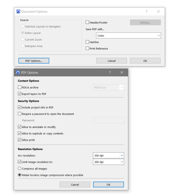

under document options in your publisher you need to set the arc resolution higher.
