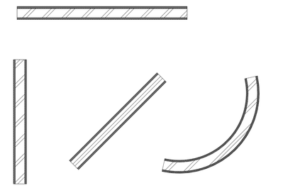

Hi i've been wondering how to align cut fill to reference line, image attached shows that it works fine with up-down left-right wall, but it messes up when the wall was curved or in diagonal. is there any way to align the cut fill to reference axis?
Solved! Go to Solution.

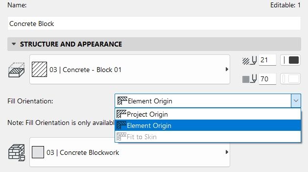

I know it can align with the wall as long as its straight, I doubt it can be done with a curved wall.
Check the setting in Building Materials and fill orientation associated with your material.
3 weeks ago
If your fill type is Symbolic, you can use the "Fit to Skin" option. This will curve with your elements.
