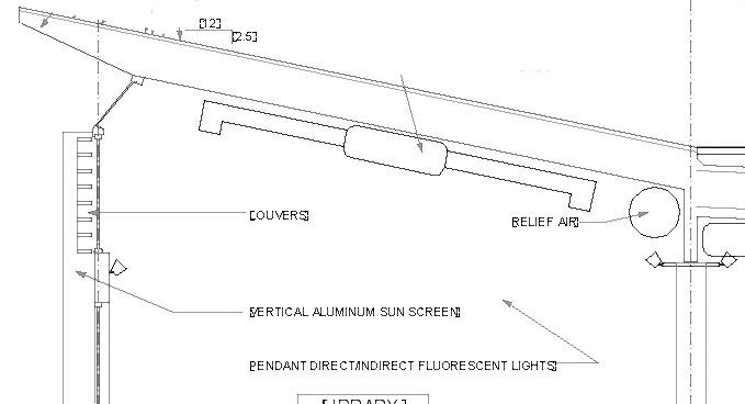

Hello,
I am recently new to Archicad and am lookig for some advice on making a custom roof edge profile. I have looked at all of the materials that came with Archicad but can only find how to change the fascia angle.
Is there no wa to make a custom edge profile like ADT or Revit? I have attached an image of the edge. An advice would be appriciated.

Cphubb wrote:
Is there no way to make a custom edge profile like ADT or Revit? I have attached an image of the edge. An advice would be appriciated.
Unfortunately, no ... this has been on the 'wishlist' for some time.
For the roof that you show, it appears that your edge is a simple cut, and so you can do this with a few steps by drawing another roof at the pitch of the cut for your fascia in a layer named something like "Hidden cutting objects" which is set to show up in wireframe, and use the Solid Element Operations to subtract the cutting roof from your real roof.
By having your cutting roof be in wireframe, you can see it and the result of the operation in the 3D window (if it is not wireframe, then just turn off the layer to see the result - use QuickLayers while in 3D). You can go into a section window to precisely drag the cutting roof to where it must intersect your physical roof edge.
Shaped edges require using the Profiler add-on to generate an extruded shape to slap onto the drip edge. Adding a shaped profile to a rake edge is trickier.
We can only hope that one day GS will feel our pain and grant our wish...
