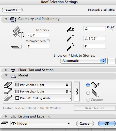

Custom Roof
How does one get the custom button here to light up in order to use it?
5 Replies 5
You get custom angles by clicking edges and using the pet palette. The settings dialog only shows if this has been done and allows you to reset all edges to vertical or perpendicular.
This Pet Palette?
TomWaltz
Right idea, wrong palette. You have to do click on the edge instead of the corner point
Tom Waltz
Link
Graphisoft Partner
Graphisoft Partner
Right idea, right view, wrong pet palette option.
Try the 'Set Roof Edge Angle...' at the top right. Get that option by selecting the roof and clicking with the mercedes cursor on the top edge of the overhang of the roof.
Cheers,
Link.
Karl Ottenstein
Moderator Emeritus
Screenshot of what you want attached. Works in 2D or 3D (3D shown).
Karl
