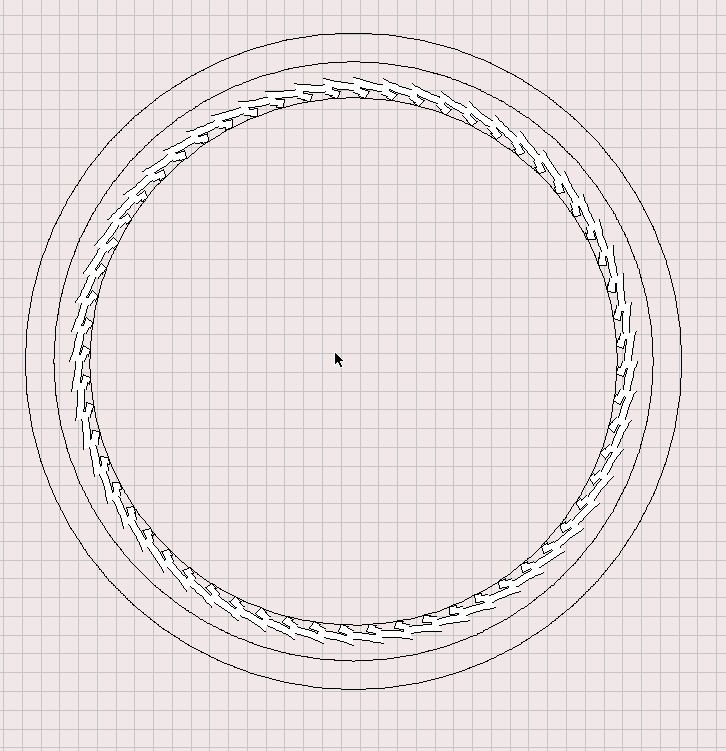

To my amazement, it works in 3D, but straight or curved, my custom profile elements won't make a symbol in the plan.
So I won't be making a wild goose GDL object after all.
Any comment?

Okay, so the arch custom profile as a beam, tilted to 30 degrees with magic wand set to 1 metre segments. What if?

Dwight wrote:
What if?
your 'barrel thing' profile canted to 30º and tilted 30º . . .
try orbiting that at speed and then walking in a straight line to the kitchen .
. . looks like the old western movies where the wagon wheels are turning in reverse.
b e n _ f r o s t
__archiben
the floor plan representation isn't actually too bad either.
i take it that your floor plan problems earlier weren't resolved using 'automatic' placement and the 'projected'/'projected with overhead' options with the beam's 'entire element'. . ?

segment....

back to 'barrel vault'

Duplicating your settings gets me a symbol in plan. Thanks.
That's a beautiful circle....

it seems that a beam will only 'cut' for the cut plane if it's inclined . . .
