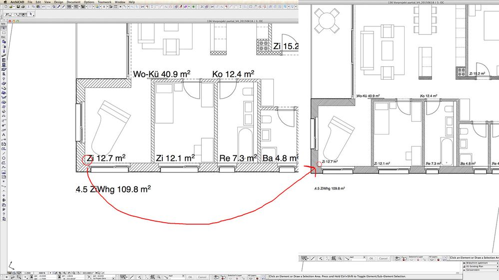

I am using Fills with area text + added room name as a usual way to label rooms etc. In our office we put label into lower left corner (+ 10 cm in x,y) in the relative direction of building.
My main problem is, when I change the scale of the drawing I have to redo all the manual positions for new scale. Sometimes we use same drawing in 3 different scales, i.e. 1:50, 1:100, 1:200 that means 3x doing the same operation.
I understand the need for different positions for different scales in some scenarios but in my case this is big loss of time. Is it possible somewhere to turn this off? Or is there some other way of doing this?

Is the anchor point of the text set to the bottom left? If so, as you change drawing scales it'll stay in the same place IF you the text contour offset is set to zero. Unfortunately, if there is any offset applied, it doesn't "stick" when changing scales.

I don't think that you can set anchor point for Area text. Or least I don't see that option.

No there is no anchor point for the area text.
A zone stamp will scale and retain its position but only if it has been scripted to do so.
I think most zone stamps will be scripted to anchor at the centre or centre top.
The only other alternative I see is to have an area fill for each scale in separate layers that you can turn on and off as required.
Then set the text position as you want it in each scale and it will stay as it is supposed to be when ever you turn that layer on for that particular scale.
At least that way you don not have to keep moving the one piece of text every time you change scale.
You will have one for each scale that you set once and forget.
