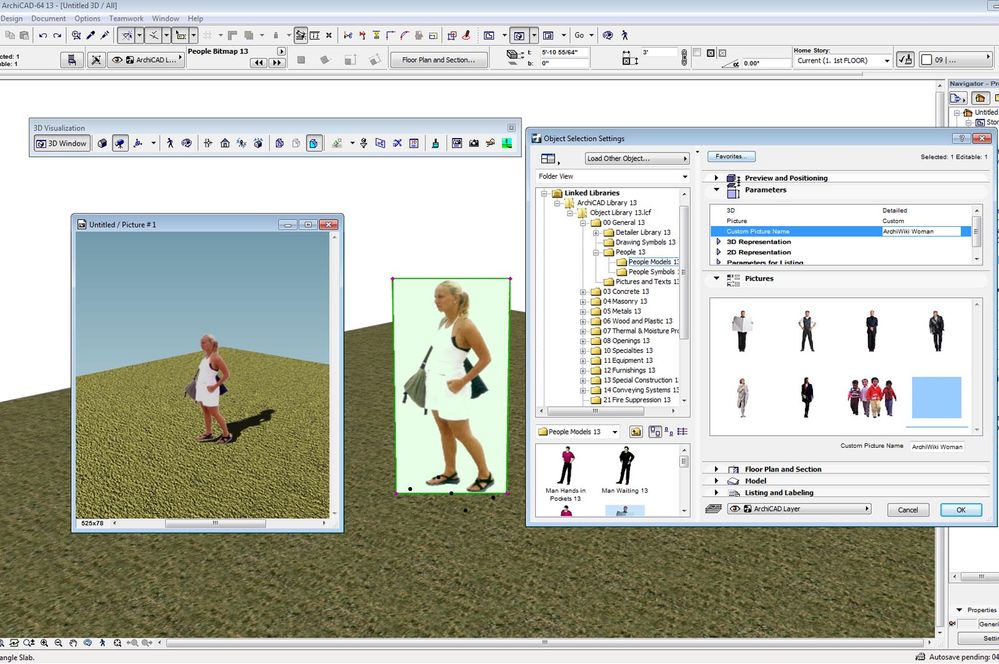

I just repeated the ArchiWiki and got this result in AC13:

Višnja:
To get your image to work in AC13, I converted the Gif to Tif and added a alpha channel. [The original gif works as is in 17, so there appears to be a change to the way masking is handled.]
