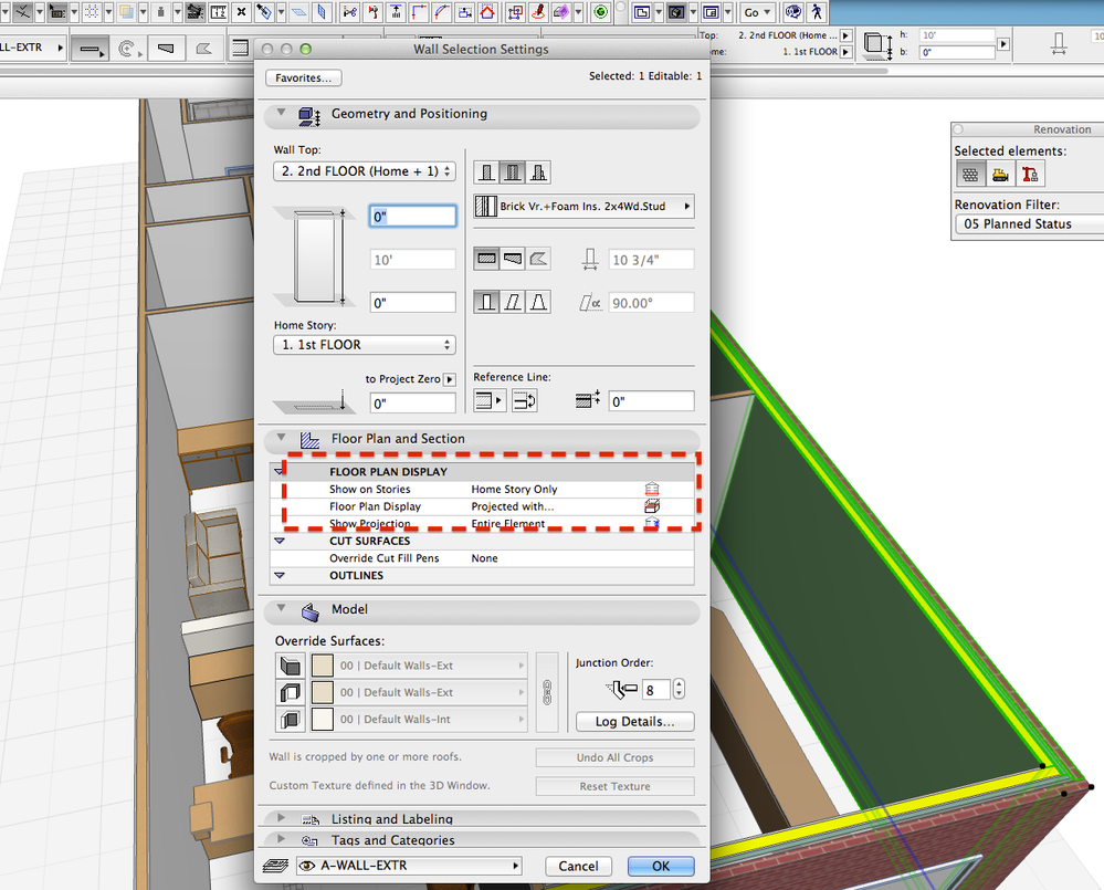

I know what each of the setting does for like story settings, cut planes etc. But Where I get confused and lost is when something is changed on the plan and it causes something to show up that never showed up before.
Example, I have a bay on a house on the 2nd floor, it is cantilevered out, but now it is showing on the 1st floor. Home story is set to 2nd floor, doesn't extend down, cut plane is set to 4' above main floor.
Just not grasping or seeing where these things start showing up when I don't want them to and didn't show up before. (I also have a vent that is in a gable that is well above the 2nd finish floor now showing in the wall on the 2nd floor plan.
Sincerely, driven nuts.

Have you tried choosing the elements (walls) that show on the first story and selecting the appropriate "Show on Story" in properties?

Do you have any offsets in your Floor Plan Cut Plane settings?
If you do and the walls are set to show on all relevent stories you will still see them although they do not actually go into the storey above or below.
This is my current settings.
You have show down to 1 storey below.
What happens if you change that to current storey?
Nothing. I have went on both floors and changed all of the settings around to different combos and it does nothing. One day it is showing everything like I am needing and then all of the sudden (I'm sure some setting was changed unknown to me), but now I have all of these story setting errors and displaying things that didn't show up before.
I have tried all of the obvious things in the beginning but it does nothing at all.
*face-palm*
after working on it and changing every setting on the cut plane and everything else, I figured it out. I had to highlight the walls showing and switch them from home story only to all relevant stories and then back to home story only. That "shocked" it out of displaying on the wrong story.
So FYI in case anyone runs into this in the future.
