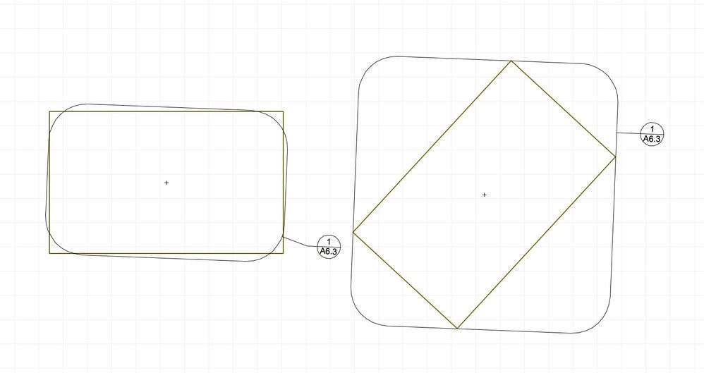

I'm having a hard time figuring out how to show the detail marker boundary (using the rounded rectangle marker polygon) at an angle. It seems that if I rotate the tool, or stretch the boundary, or change the boundary to a polygon, that the "clipping path" always draws lines parallel with the original grid lines. This also true if I rotate the plan view. Anyone else experiencing this problem?

ArchiCAD 15 introduces a new control into the detail marker see attached

Perfect, thank you!
