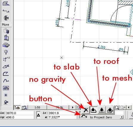

I have two building at one site with different level, how do I deal with the story setting?

If you want both to show on same plan, set floor slabs at appropriate levels and use gravity when placing walls, objects, etc. See attached gravity options.

WONDERFUL, THANKS.
