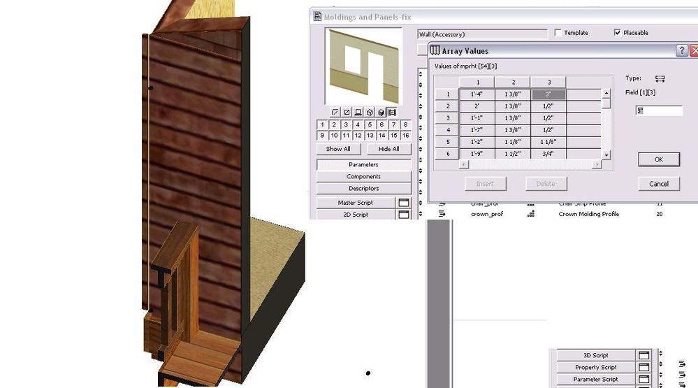

I am using the Wall Accessories - Mouldings & Panels to model a wall with two different siding treatments. The Wall is specified as a Cedar Shingle and the Wall Accessory is a Base Board with a 8'-1" Height and a Material of Horizontal Siding. All is well except for the ends of the wall. The Molding or panel adds an extra little piece at each end.

The "Bug" while may be hidden in the code can be easily bypassed for the common user fairly easily. The extra wall section that appears on certain profiles shows up due to a wall cutting body width that is not big enough to cut out the full overhang of the molding object. I ran into this problem while creating our siding accessory object (Horizontal, Vertical & Log Siding) An easy way to fix this is to increase the cutting width value in the "molding profile height" matrix named mprht. attached is a series of pictures that will tell you what is needed to be done in order to fix this bug.

This sounded Promising......... I must be a little bit under the "common user"
I am using the material number 1 for my "Base" / Siding. I changed the value in the third column from 1/2" to 3". Was this not enough...?
The Screen shot shows the extended portion still...
If you have ANY profile set on that has this error, it applies it to all of the molding ends. even if your base molding is set and you have changed its 3rd column setting, if the chair or crown is bugged, it will bug the entire object. i would try to remove the crown, and chair or go into the array like i described but from the objects param list. this way any changes are "tested" and not permanent. once you have three clean profiles you should have a nice clean object.

The Problem lies in the "Cutting Body".......
To rectify the bug, open the obj. in Lib Parts editor, go to 3D Scripts and look for script under "Cutting Bodies", increase the values of Reference Thickness by 0.5 (enough to cut out the remainding portions):
