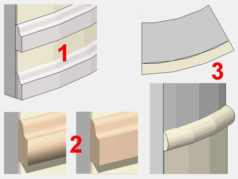

Bingo! This is for curved walls.
1 - The wainscot does not start at the good level.
2 - Base, chair and crown are not correct in rendering.
In the macro "Profile Revolver", some status code should be 2 instead of 0.
2 - Empty base results in an alert, and can not be done.
3 - Wall accessory resolution is the same as wall resolution, ok, but the origin should coincide with the wall origin
and the accessory should follow the construction method of the curved wall :
Always start with a half straight segment, and finish with another straight one (not automatically half),
the only way to have a clean junction and a smooth rendering between straight and curved parts.
Difficult, i agree, but doable. This should be the most important, for me.
Because of this lack, one can not use a single chair or crown, without wainscot or wallpanel (lines don't show). It is a pity.
