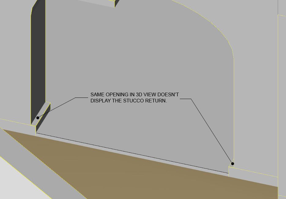

I have posted a few images. In floor plan, the wall skin return at jamb as intended. However, in the 3D view the finish wall skin doesn't. In this case, the stucco wall skin doesn't appear. Am I missing a setting?

What opening are you using, and what are the settings?
Do you have 'Show in 3d' ticked in the Turn Plaster section of the Wall Closure settings for that opening?
It is also worth adding your ArchiCAD version and basic computer specs to your signature, as the answer to many questions can vary depending on this info.
