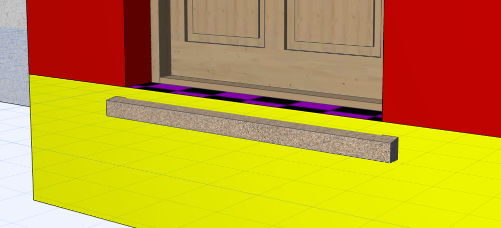

Hi probably a really easy fix but I can't seem to find the answer myself.
How do you show a door sill correctly. My sub walls and main wall intersect at ground level as my wall construction changes at this level however this then creates a problem where my door sill is past the end of the wall it sits in thus the wall underneath cuts through the sill ?
How do I stop this ?

Add an Empty Opening (Simple Door Opening) to the lower Wall. Doors and Windows only cut the Wall they are placed in.
David
David Maudlin / Architect
www.davidmaudlin.com
Digital Architecture
Or use a complex profile wall that combines the different wall types.
Then you have only one wall and the sill should cut it properly.
You can model the walls separately, select both then EDIT > REHAPE > MERGE WALLS.
This will create the complex profile for you and even swap it with the two walls.

Both doors and windows have poor top and bottom detailing in section so you need a work around.
I create the door sill as a separate complex profile, beam or wall, and place that on the storey below ground level. That gives you control over everything and you can show DPC details correctly.

Apologies you have lost me purely as I was unaware you could do this ! (Self taught so probably loads I do not know) The ground floor wall and substructure walls are made up of two different composites so will this still work ?
shaneharman wrote:
Barry,
Yes this will merge any parallel walls into a single composite keeping their original materials.
It will replace the selected walls with a 'Custom' complex profile, which you are best to open in the Profile Manager and then save as a complex profile with a meaningful name.
Then swap the selected 'Custom' profile in the plan with the newly save profile.
Otherwise you can end up with many 'Custom' profiles in your plan and you will have no idea what they really are.
Plus you need to save it as a new profile so you can use it again for other walls.

So am I right in thinking once I store it as a complex profile I can use it as a wall type but the height of the wall type will be set as per the complex profile and not height adjustable ?
Solution
Walls place with complex profiles can be increased in height but can not be decreased.
So the actual profile is the smallest your wall can be.
You can edit the fills in the complex profile to make them shorter.
You can also set the vertical stretch extents so only a particular part of your profile stretches (i.e. the upper part of the wall) instead of the entire wall proportionally.
